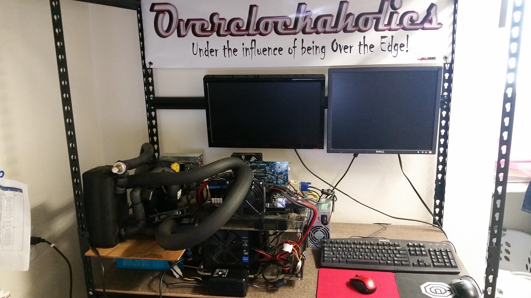

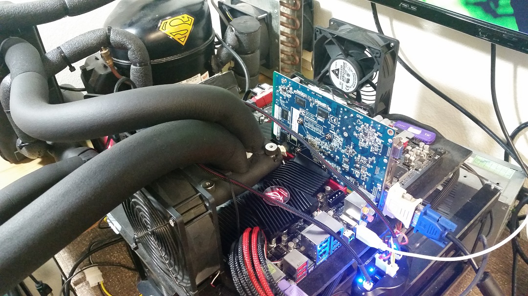

Finished motherboard insulation and cleaned the area a bit.

Old 07-19-2015
Your insulation job looks tight from the pics bro, nice work. Might need some on the mounting screws tho or just papertowel.
Hats off, fine job.

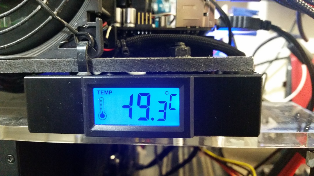

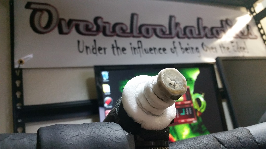

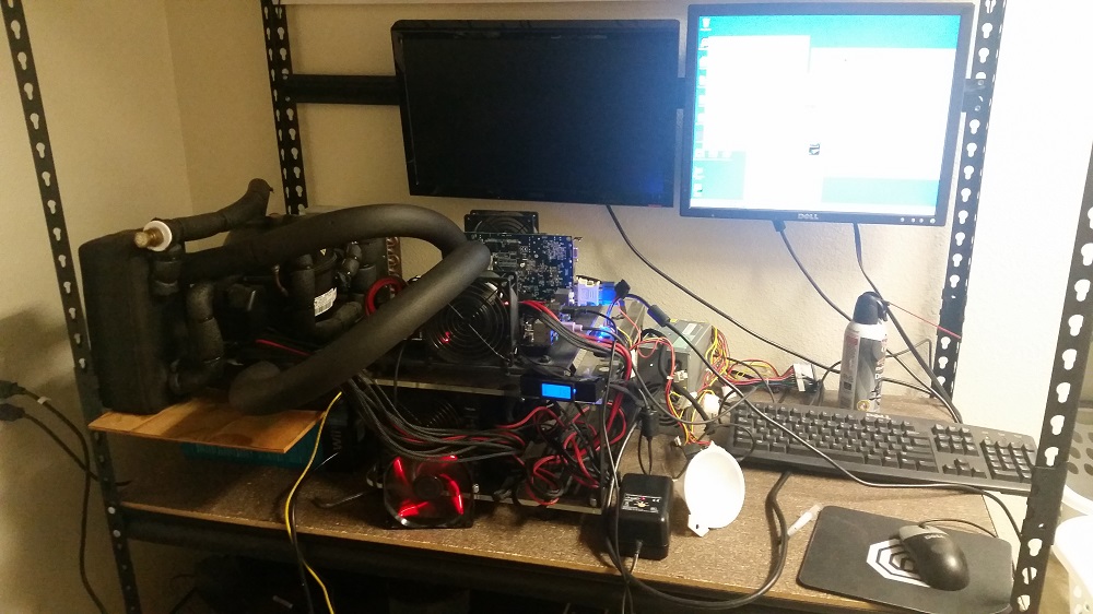

Ran some CPUz today. http://valid.canardpc.com/dhrjln
CPU water/methanol inlet temp -19c
CPU temp in bios -6c
Problems:
1. Could only disable 4 out of 6 cores.
2. CPUz reads 2 cores 6 threads no matter how many are activate in bios.
3. TXV and Pump frosted up. Need to insulate a bit better.
