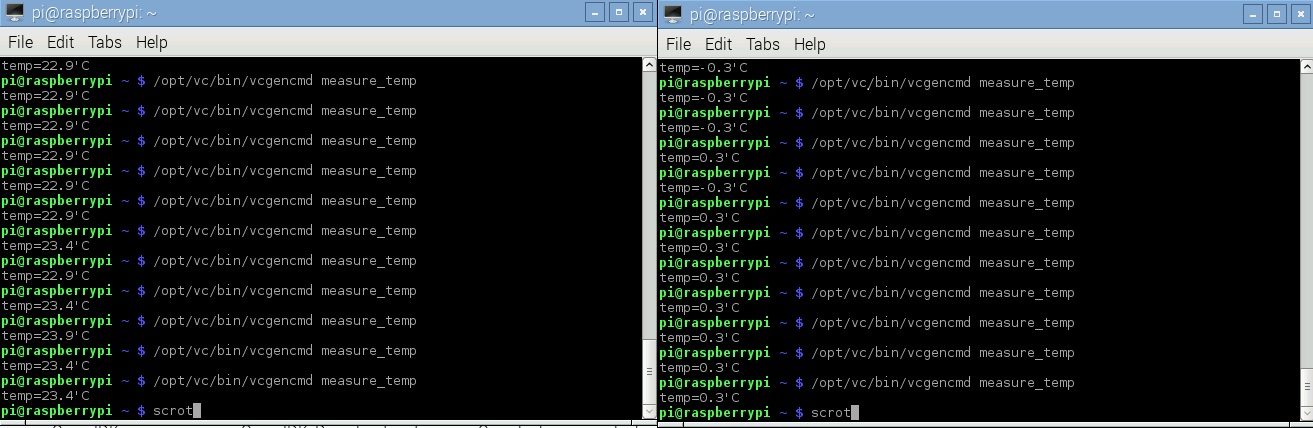

OC Maximus 08-03-2015 07:34 PM
Picked up a couple cans of Power Duster and took her down to -20C.
Found the limit with 1.4v to core. Ready for vmod :)
Overclock:
force_turbo=1
arm_freq=1140
gpu_mem=50/50
core_freq=500
sdram_freq=500
over_voltage=8
http://i464.photobucket.com/albums/r...psaouiu8yo.jpg
http://i464.photobucket.com/albums/r...psnkrlf6km.jpg
http://i464.photobucket.com/albums/r...psqkdn7ofd.jpg
http://i464.photobucket.com/albums/r...psb7lasuls.jpg

OC Maximus 08-03-2015 08:56 PM
Think I'm tapped out at 1.4v
1.2v is default
https://www.raspberrypi.org/wp-conte...sue2.2_027.pdf
I didn't really plan on going subzero today. Just threw a little eraser around the arm cpu and went for it. 3 hours later started to get condensation issues. Next time I'll do a proper insulation job so hopefully it won't be an issue.

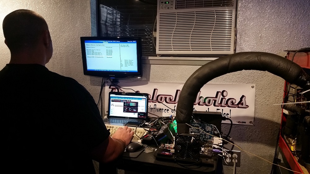

OC Maximus 08-04-2015 09:59 AM
1 Attachment(s)
Attachment 7701
