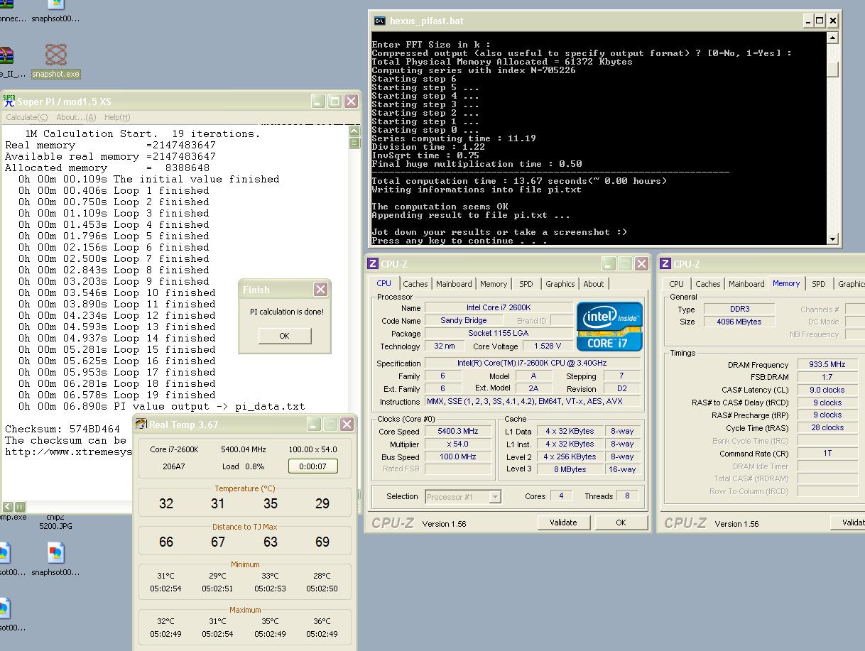

here is 3rd boot, easiest so far dont mind the time
found out what cuts the power off when I start pi, this wasnt 1m stable until I switched it
Not bad Splave, Might I suggest running Waza though?
And whats cuts the power off when you start Spi??? I had an issue running spi on a system that was wPrime stable... I just added more juice though...

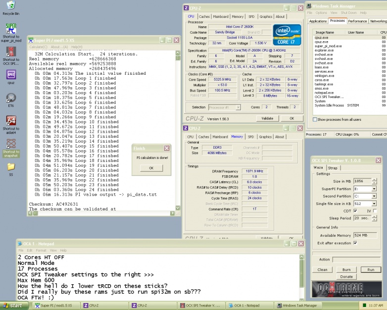

Tweaked rams and still need to figure out how to lower tRCD. I'm open to suggestions
  #97
