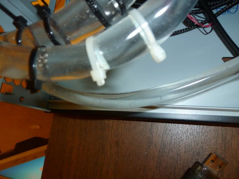

Dear friends and family, Tu Fu came with another question.....
In the picture below is part of my rig's tubing, I was wondering why is some of my tubes are like retarded? you see the higher one it's got ziptie on it to keep it around and the one that's right below it is like flat...
Why is that?
It don't seem like it's effecting the cooling much but just wondering why the hell is it retarded like that how do i fix it?
I think it may have too much negative pressure in the loop and the tube is extremely soft

Kiki,
That's usually a sign of too sharp of a curve, or, the tubing is torqued.
you need to make all your bends large enough do the hose doesn't collapse. As I remember, your tubing looked pretty good??
Sometimes if you tighten a tube to a fitting and then turn the fitting down tighter, the tubing is torgued, twisted, which can cause it to flatten. If you try to turn a hoses curve against the shape that it's used to being in can cause this too.
You can also get that spiral tubing support stuff - works, but I was never a fan of how it looked.
You got top of the line tubing so I'd guess you torqued them during installation ?

If he got tygon tubing from what I understand it is very soft, I never used it myself. I just get the stuff from home depot, braided and really hard to flex lol

Also, I popped the cap on the water res and released some of the pressure and replaced it with water and it don't seem too too bad now but that one tube still looks like handicapped
