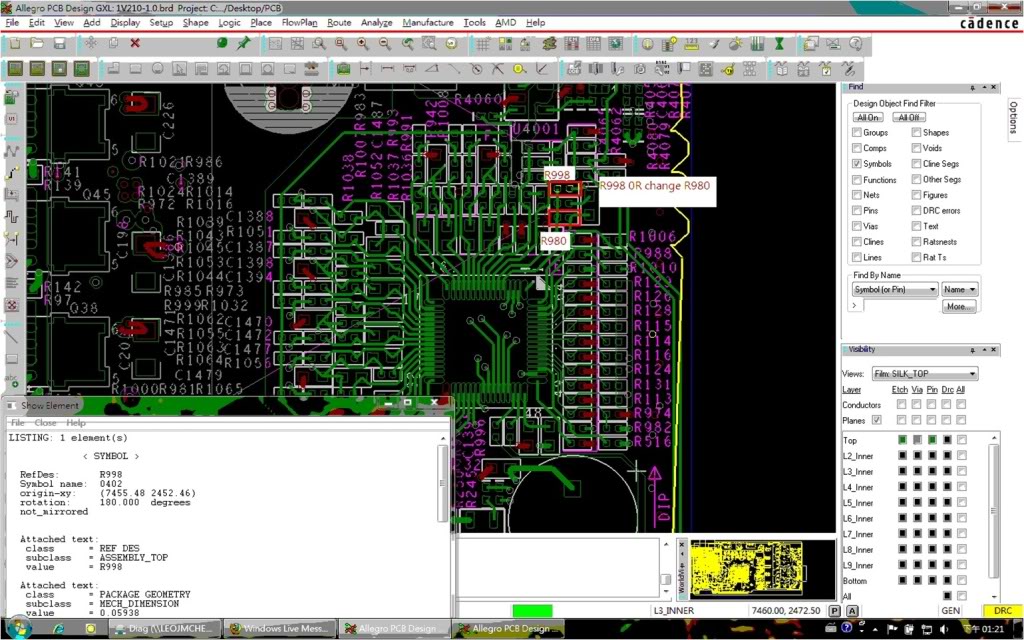

Found this but not too sure how to implement it any clues?
Thread: http://www.xtremesystems.org/forums/...d-thread/page5

Hes is talking about changing resistors to up the voltages Id assume, I read forward from the past to find it. Pretty much what you need is in that link, the resistors they use are adjustable(usually)
1. changing the resistor should bring increased vMEM to max safe limit.. manufacturer did not realize gains past new voltage limit- so my guess is its not going to benefit.. VR should do just fine though.
2. OCP overall- as stated..overall GPUv OCP control/disable... OCP phase = OCP limit per phase - must for high vcore
3. vGPU is only VID, by default.. can still bump with software though, it just sets new default per VID mod.
hope that helps.
*vDDCI mod is must too... folks not seeing gains beyond ~1.25v though. I have not been able to monitor vDDCI for droop under load yet, but suspect capping might boost FPS in the same fashion PLL mod/cap works for 470/480

Have you seen this? I don't think its a lightning. But check and see if the board layout is the same bro.
http://img405.imageshack.us/img405/3526/5870vmod.jpg
  #109
Old 03-01-2014
Hey Duke i saw that but it isn't for the lightning.
Found a guy name T_M that did 2 OCP mods and the Vgpu about halfway through this thread.
http://www.xtremesystems.org/forums/...d-thread/page6
Which doesnt look too bad but somewhat hard to make out the mod points and the VR's he used.
